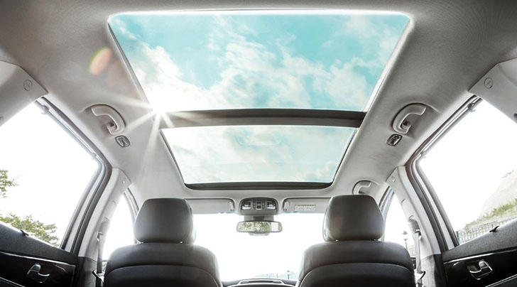

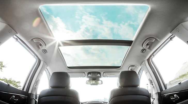

    Jemand hat eine in Voyager? Gedanken?
    I always thought a panoramic one would be awesome...cut out of a "donor" car and weld in

    there was a roof Available from Webasto for the Voyager, with Paperwork (for TÜV) and everything!
    Its the same as used in the VW T4. Its name depends on the Year is is built, either "Top Slider Medium" or "Hollandia 300 Classic".
